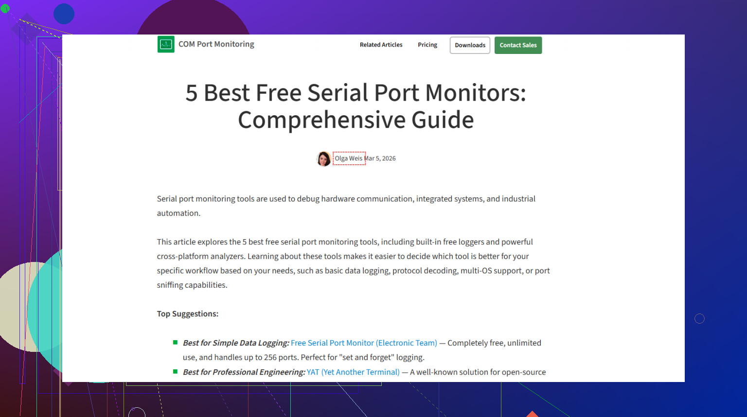

If you need a list of options and what each one does, this breakdown helps a lot:
free serial port monitor tools for Windows compared

  6. Good overview resource
    Since you asked about the best free serial port monitor for Windows, you might want a side‑by‑side comparison of the common tools, which ones are user‑mode, and which hook the driver stack. This breakdown is actually pretty good for getting the lay of the land:
    top free Windows serial monitoring tools compared
    It helps you quickly see which tools are terminals vs true sniffers and which are actually usable on current Windows builds.
