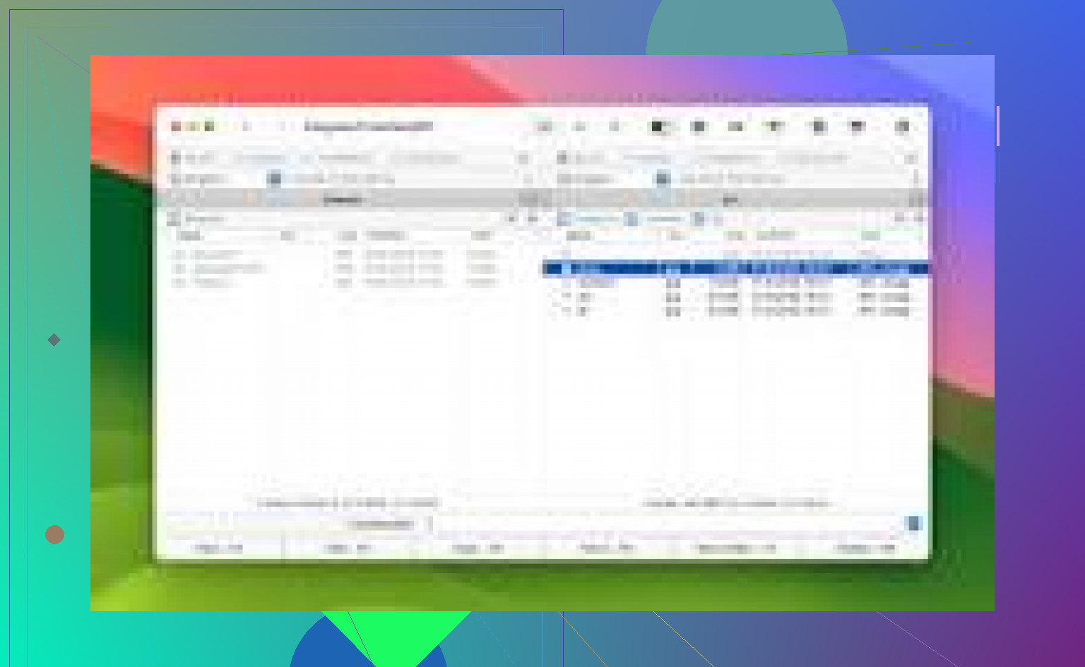

First thing I did was the usual Mac check. In Finder, I hit cmd + shift + . to show hidden files. Nothing. Tried the same drive on my own Mac. Same result. At that point I was irritated enough to think macOS was eating files in the background and pretending nothing happened.

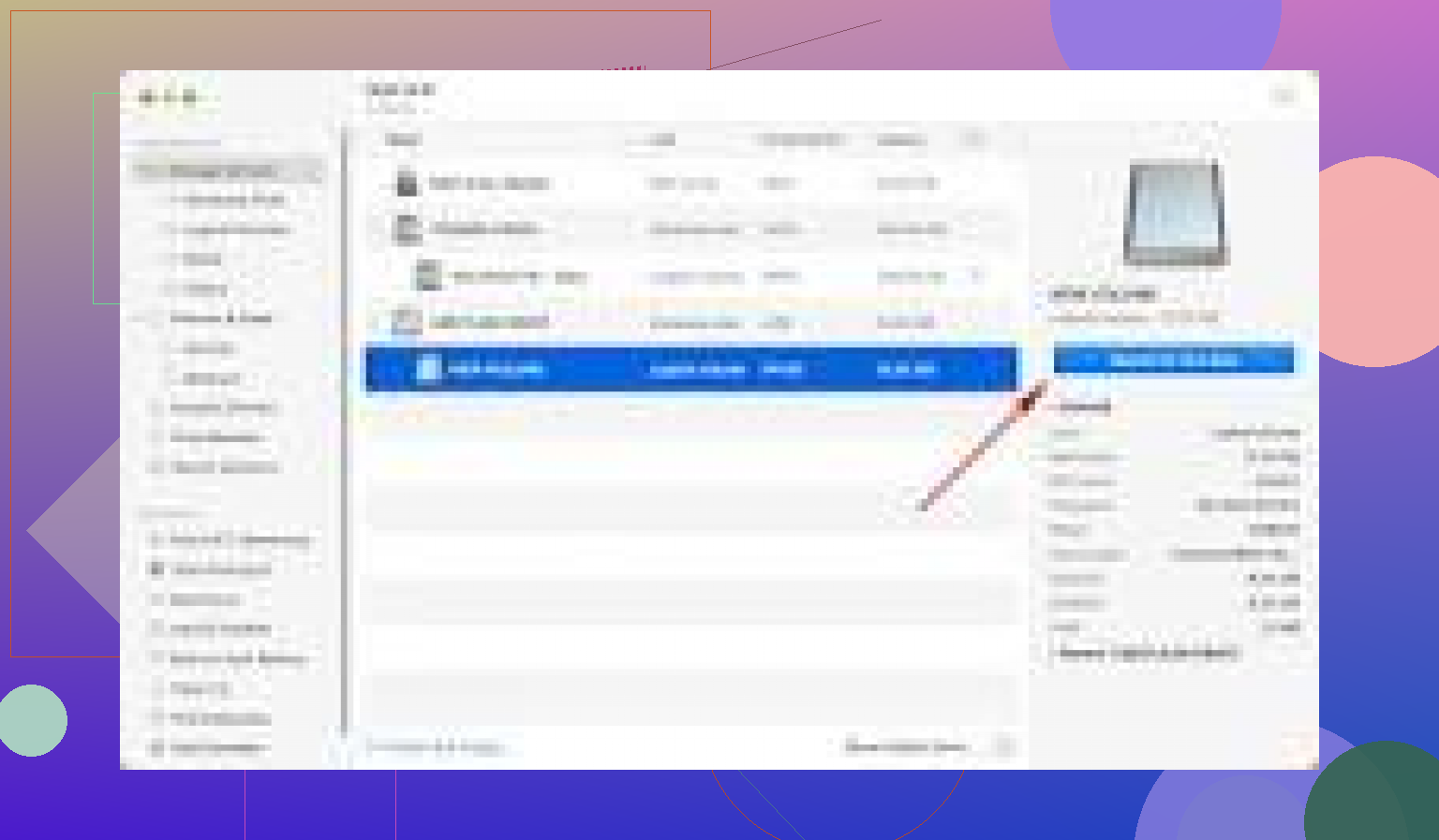

The steps there were plain and useful. It covered how to scan the USB drive properly and pointed to a recovery tool that still found files even though Disk Utility reported the drive as healthy. Mine clearly wasn’t. I recovered most of the missing files. A couple came back damaged, but the important project stuff was readable, which is all I cared about.

  4. Run First Aid in Disk Utility only if the drive is acting broken. I disagree a bit with @mikeappsreviewer here, because a healthy-looking drive in Disk Utility does not mean your files are fine, but First Aid can also modify directory data, so I would not make it step one for simple deletion.
