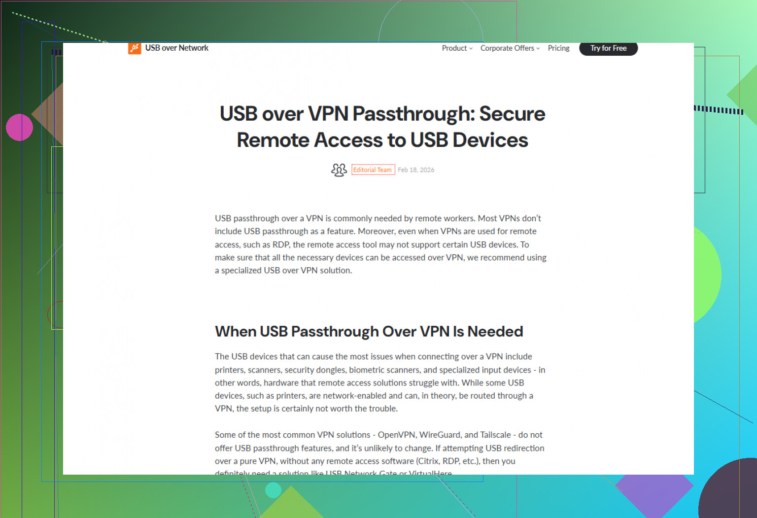

If you want a clear setup tutorial and more detail about options, routing, and common errors, this guide helps a lot:
Step-by-step guide for using USB devices through a VPN
