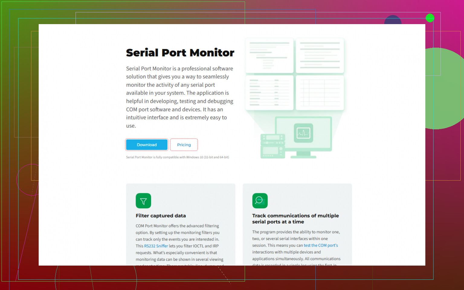

If you just want your serial traffic logged 24/7 without babysitting it, you can totally script that with a serial port sniffer that accepts command-line arguments.
One option:
Serial Port Monitor from Electronic Team. Not shilling, just what I ended up using because it actually lets you control the basics from the command line: which COM port, where to save the log, and how big the log is allowed to get before it rotates/stops.
Basic command-line setup
Once it is installed, you can kick off logging from a shortcut, a batch file, or Task Scheduler. General idea looks like:
SerialPortMonitor.exe /port COM3 /log ‘C:\path\to\logfile.txt’ /maxsize 1048576
Where:
  • /port COM3 is the serial port you want to sniff
  • /log 'C:\path\to\logfile.txt' is your output file
  • /maxsize 1048576 is the max log size in bytes (that example is 1 MB)
Tweak the COM port and path for your setup.
Making it run automatically at boot
Two simple routes on Windows:
  1. Startup folder method
    • Create a shortcut with that command as the target.
    • Drop the shortcut into your startup folder:
      C:\Users\<your_user>\AppData\Roaming\Microsoft\Windows\Start Menu\Programs\Startup
    • Next reboot, it launches on its own and starts logging.
  2. Task Scheduler method
    • Open Task Scheduler
    • Create a new task
    • Trigger: “At startup” (or “At log on” if you prefer)
    • Action: “Start a program”
    • Program/script: SerialPortMonitor.exe
    • Arguments: /port COM3 /log 'C:\path\to\logfile.txt' /maxsize 1048576
I usually go with Task Scheduler because you can get fancier with triggers and recovery options.
Restarting it daily so it does not bloat
If you are worried about memory leaks or just want a clean log per day, you can:
  • Create a scheduled task that runs at system startup (as above)
  • Add another trigger to the same task or a separate one that runs at, say, 00:00 every day and restarts the task/program
In Task Scheduler you can also:
  • Set the task to stop after X hours and then run again
  • Or have a second task that kills the process at midnight and relaunches it with the same command line
End result: once you set this up, you do not have to click anything. Windows boots, the serial monitor starts, it watches your chosen COM port, and it keeps appending to your log file up to the size limit you picked, all hands-off.

To complement their ideas, here’s how I’d structure things in practice.
1. When a dedicated tool like Serial Port Monitor is worth it
If you are on Windows and this is a production-ish box, a GUI + CLI hybrid like Serial Port Monitor is not a bad compromise.
  • Can spy on ports another program already opened, which is hard to DIY.
  • Command line flags fit nicely in Task Scheduler or a service wrapper.
  • Built-in views: text, hex, mixed, filters, timestamps without writing any code.
  • Easier for coworkers who are not comfortable editing scripts.
  • Closed source and you depend on someone else’s update cycle.
  • Less flexible log format and rotation rules compared to your own script.
  • Not ideal on headless or very locked-down servers.
  • Licensing if you need it on several machines.
I slightly disagree with the “just one big file with a size limit” pattern. Huge flat logs are painful to grep and parse. I’d rather have Serial Port Monitor create daily or hourly logs and archive them, even if that means a few more settings up front.
A neat hybrid: use Serial Port Monitor only as a raw binary dumper, then run your own parsing and timestamp injection offline with Python or similar. That splits the problem: stable capture, flexible analysis.

You can still use Serial Port Monitor as the capture engine and have a secondary process convert its raw log to structured form periodically.

  • @mikeappsreviewer shows the “install once and forget” style with Serial Port Monitor which is probably the fastest path to something running today.

    • Yes → Serial Port Monitor is the straightforward choice.
    • No → Your own script or systemd service is cheaper and more customizable.
  2. Do I need custom timestamps, framing, or protocol decoding now or later?
    • Yes → Script or small custom app, possibly fed from Serial Port Monitor logs.
    • No → Built-in logging in Serial Port Monitor is fine.
