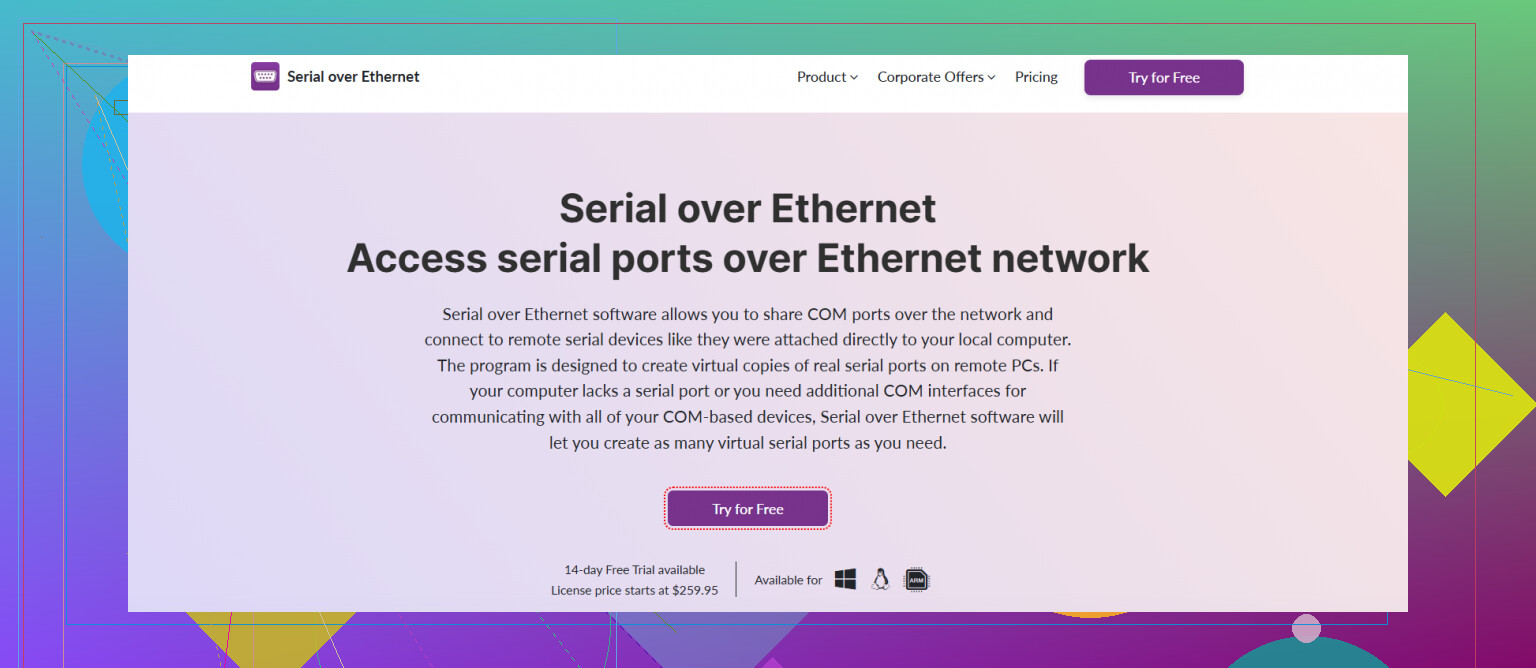

If one PC has the physical COM port and you just want to share it over the network, use a virtual COM port / TCP redirector:
  • Install something like Serial to Ethernet Connector on the machine with the actual RS‑232 port.
  • It creates a server that exposes that COM port over TCP or UDP.
  • On your main workstation, the same tool (or another virtual COM port client) creates a virtual COM port that forwards everything over the network to that server.
  • From your app’s point of view, it is just talking to COM3 or whatever, but all the traffic is going over Ethernet.
That kind of setup is basically what people mean by a serial over IP connection for legacy hardware in a modern LAN. If you want a step by step and feature overview, check out something like
using serial communication over Ethernet on your network
which explains how to map remote serial ports to virtual COM ports and support things like multiple clients, encryption, etc.
  • No extra hardware if you already have a serial port.
  • Lets you keep the old device exactly where it is.
  • Needs that “server” PC to stay on.
  • Network hiccups can look like flaky serial behavior if your app is picky.
