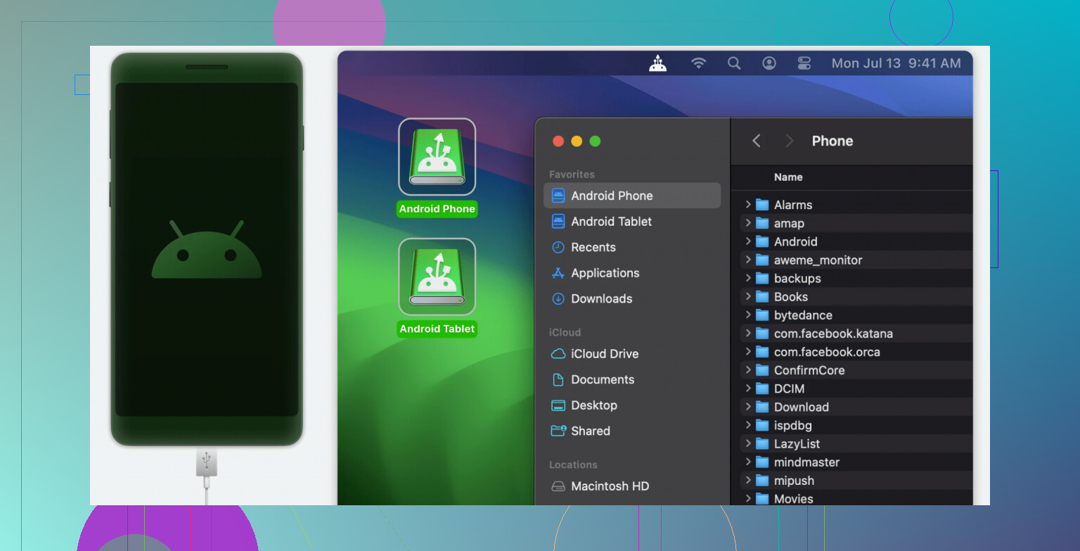

Honestly, at some point, I chose to avoid the hassle altogether. I grabbed MacDroid. It talks to Android devices via USB or Wi-Fi and shows your device right in Finder, no extra setup madness. Life’s too short to wrestle with default tools that don’t want to cooperate.

Before you go elite hacker mode or spend a weekend sifting through Security & Privacy panels and murdering daemons, consider a different approach: MacDroid. It’s not bulletproof—nothing in the Android-and-Mac circus is—but it does a solid job letting you move files with minimal head-slamming. Major pro: it actually plants your Android in Finder, right where you want it. Bonus—it can rock Wi-Fi mode, so you can skip the “which-cable-is-this” existential crisis. Cons: it’s not free, and yeah, not open source, which might give some the icks, but sometimes “it just works” outweighs those gripes in the trenches.
