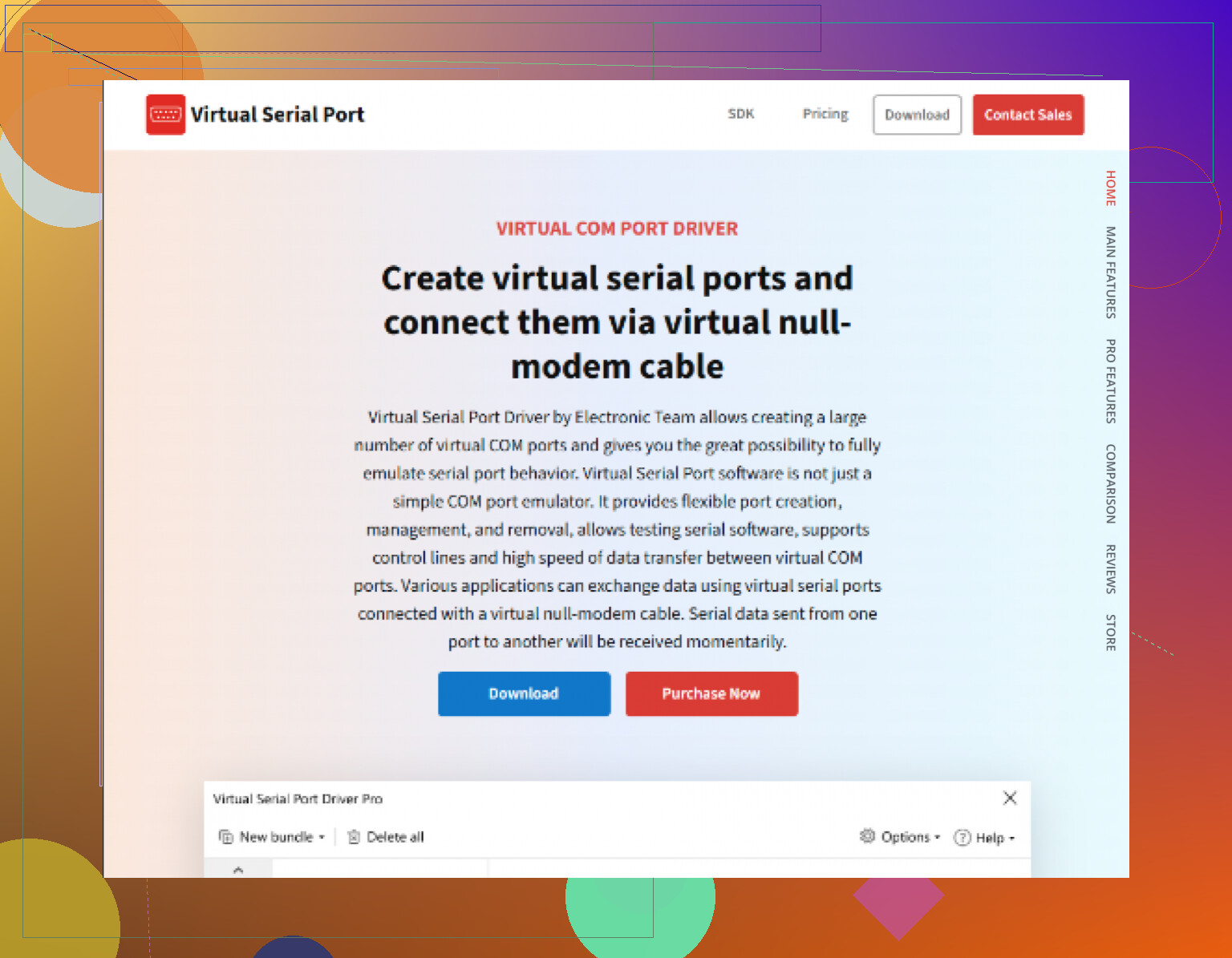

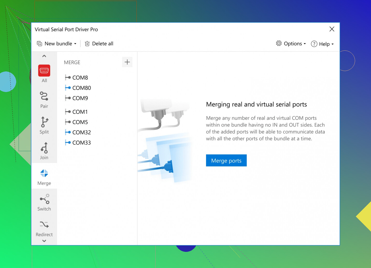

If you want an option that’s polished, there’s a reason “Virtual Serial Port Driver” stays top of the search results. It’s more of an enterprise solution, but dang, it actually works AND doesn’t turn your registry into a dumpster fire. Makes virtual COM ports that the apps can attach to, splits the hardware traffic, and keeps everything in sync. Here’s a rundown on how to share one serial device between several programs if you wanna dig a bit deeper.

If you want to sidestep the frustration (and don’t mind a little install clutter), try the well-reviewed Virtual Serial Port Driver free trial—kinda the gold standard in consistent serial port splitting, even if it’s not exactly wallet-friendly for hobby projects.

Here’s the deal—splitting a serial port on one machine so two apps can grab the same feed isn’t really a native OS thing. Like others pointed out, Windows locks you out, and Linux is only slightly more forgiving for clever types. The heavyweight “fix” is picking up a tool like Virtual Serial Port Driver.
Pros? First, it’s reliable: create virtual pairs, and suddenly each program connects to its own virtual port, both relaying the same data to/from the real device. Setup is straightforward, and the interface doesn’t make your eyes bleed. Great for devs, integrations, and, honestly, for anyone trying to wrangle GPS feeds and diagnostics without epic crashes.
Cons? The price tag is not hobbyist-friendly. Free trial is there, but after that, get ready to open your wallet. Low-level timing—sometimes not as crisp for super-precise stuff (think legacy CNC or MIDI gear). And if you’re anti-third-party installs, this isn’t a DIY miracle.
Competitor-wise, options like Serial Splitter (as mentioned by others) and socat (for the Linux faithful) exist. Socat sounds cool, but it’s command-line heavy and can be a headache for beginners. Some people have success with hardware sniffers, but that means more wires, extra boxes, and a “just read, don’t touch” approach for secondary apps.
TL;DR? If you really need two apps talking to the same port like best buddies, Virtual Serial Port Driver gets the job done with minimal fuss, at a cost. But don’t kid yourself—it isn’t magic, and for ultra-sensitive real-time operations or penny-pinchers, it’s not ideal. For everything else—especially if you value sane setup and support—it’s the adult solution in a world of messy workarounds.
